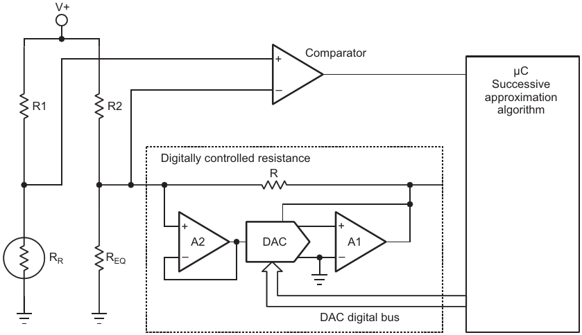

Program resistance in a bridge circuit
Figure 3
13 Kb
Figure 1. By measuring V
BRIDGE
and adjusting R
EQ
, you can balance a bridge circuit and calculate R
T
Figure 2. a) Programming the DAC's output voltage changes R
EQ
, which can balance a bridge circuit. b) Equivalent circuit
Figure 3. This schematic of a circuit uses a comparator across the bridge
