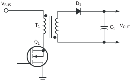

The traditional flyback converter …
The traditional flyback converter puts a voltage stress on the switching transistor comparable with the stress of the one-switch forward converter

Figure 4. The traditional flyback converter puts a voltage stress on the switching transistor comparable with the stress of the one-switch forward converter
