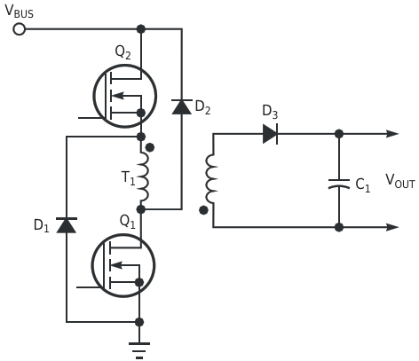

Like the forward converter, …
Like the forward converter, the two-switch flyback benefits from fixed stresses on the switching components and lower noise

Figure 5. Like the forward converter, the two-switch flyback benefits from fixed stresses on the switching components and lower noise
