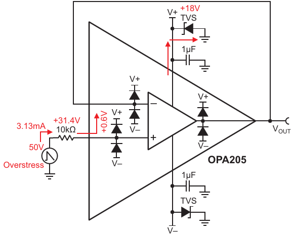

Figure 2. The electrical overstress (EOS) protection scheme shown uses the OPA205 precision op amp
