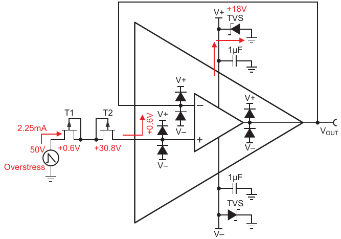

Figure 3. The JFET input protection shows the circuit operation under fault condition
