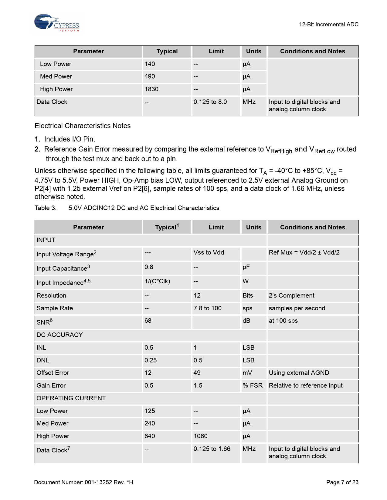

Parameter. Typical. Limit. Units. Conditions and Notes. Typical1
Parameter Typical Limit Units Conditions and Notes Typical1
12-Bit Incremental ADC
Low Power 140 -- µA Med Power 490 -- µA High Power 1830 -- µA Data Clock -- 0.125 to 8.0 MHz Input to digital blocks and analog column clock Electrical Characteristics Notes
1.
Includes I/O Pin.
2.
Reference Gain Error measured by comparing the external reference to VRefHigh and VRefLow routed through the test mux and back out to a pin. Unless otherwise specified in the following table, all limits guaranteed for TA = -40°C to +85°C, Vdd = 4.75V to 5.5V, Power HIGH, Op-Amp bias LOW, output referenced to 2.5V external Analog Ground on P2[4] with 1.25 external Vref on P2[6], sample rates of 100 sps, and a data clock of 1.66 MHz, unless otherwise noted. Table 3. 5.0V ADCINC12 DC and AC Electrical Characteristics
Parameter Typical1 Limit Units Conditions and Notes
INPUT Input Voltage Range2 --- Vss to Vdd Ref Mux = Vdd/2 ± Vdd/2 Input Capacitance3 0.8 -- pF Input Impedance4,5 1/(C*Clk) -- W Resolution -- 12 Bits 2’s Complement Sample Rate -- 7.8 to 100 sps samples per second SNR6 68 dB at 100 sps DC ACCURACY INL 0.5 1 LSB DNL 0.25 0.5 LSB Offset Error 12 49 mV Using external AGND Gain Error 0.5 1.5 % FSR Relative to reference input OPERATING CURRENT Low Power 125 -- µA Med Power 240 -- µA High Power 640 1060 µA Data Clock7 -- 0.125 to 1.66 MHz Input to digital blocks and analog column clock Document Number: 001-13252 Rev. *H Page 7 of 23 Document Outline Features and Overview Functional Description Example 1 Example 2 Incremental ADC DC and AC Electrical Characteristics CY8C29xxx Typical Performance Placement Parameters and Resources Example 1 Example 2 Interrupt Generation Control Application Programming Interface ADCINC12_Start ADCINC12_SetPower ADCINC12_Stop ADCINC12_GetSamples ADCINC12_StopAD ADCINC12_fIsDataAvailable ADCINC12_iGetData ADCINC12_ClearFlag Sample Firmware Source Code Configuration Registers Version History
